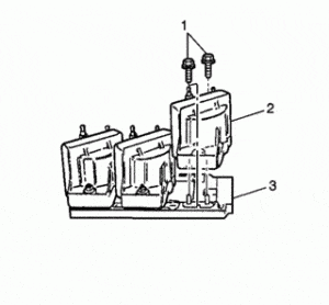

ignition module 1998 Olds 88•Remove 6 screws (1) securing the coil assemblies to the ignition control module.
•Remove the coils (2) from the ignition control module (3).
•Take off the ignition control module.

•Attach the coils to the ignition control module. Refer to Ignition Coil(s) Replacement .
Caution! Use the correct fastener in the correct location. Replacement fasteners must be the correct part number for that application. Fasteners requiring replacement or fasteners requiring the use of thread locking compound or sealant are identified in the service procedure. Do not use paints, lubricants, or corrosion inhibitors on fasteners or fastener joint surfaces unless specified. These coatings affect fastener torque and joint clamping force and may damage the fastener. Use the correct tightening sequence and specifications when installing fasteners in order to avoid damage to parts and systems.
•Install 6 ignition coil attaching screws
