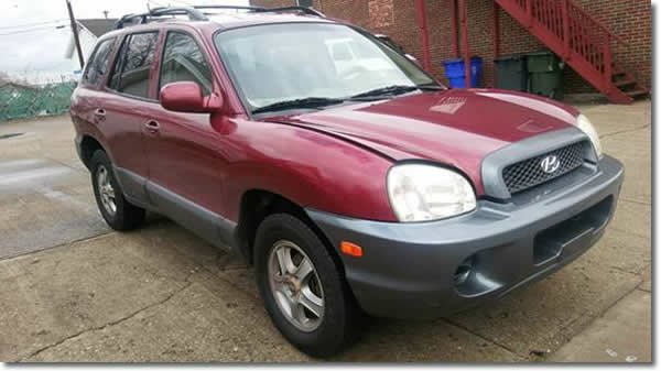

2004 Hyundai Santa FeMy car goes off when running on high or low speed. Can start again after two minutes and can travel for 45 minutes.
What is the cause?
Car goes off when running
