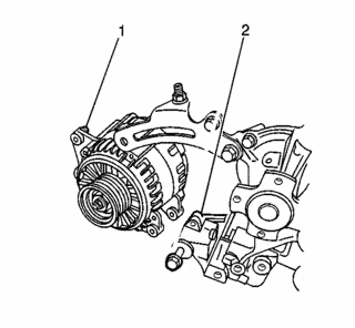

Trying to replace alternator. It is lose but can’t come out the top and CV-joint in the way so cant come out the bottom. Help please?
You will need to remove the air cleaner assembly in order to remove the alternator from the top.

Removal
  • Disconnect the Negative battery cable.
  • Remove the air cleaner assembly.
  • Remove the rubber insulator, the nut, and the electrical connector from the alternator B+ terminal.
  • Take off the upper mounting bolt (1).
  • Remove the drive belt.
  • Remove the 2 lower alternator mounting bolts (2).
  • Take out the alternator.
Installation
  • Install the alternator to the vehicle.
  • Install the lower mounting bolts (2). Do not tighten the bolts at this time.
  • Install the upper mounting bolt (1). Do not tighten the bolt at this time.
  • Install the drive belt to the pulleys.
  • Adjust the drive belt in order to obtain the specified deflection with 10 kg (22 lb) of pressure exerted.
    Used Belt Deflection
    6-8 mm (0.24-0.31 in)
    New Belt Deflection
    5-7 mm (0.20-0.27 in)
  • Tighten the alternator mounting bolts.
