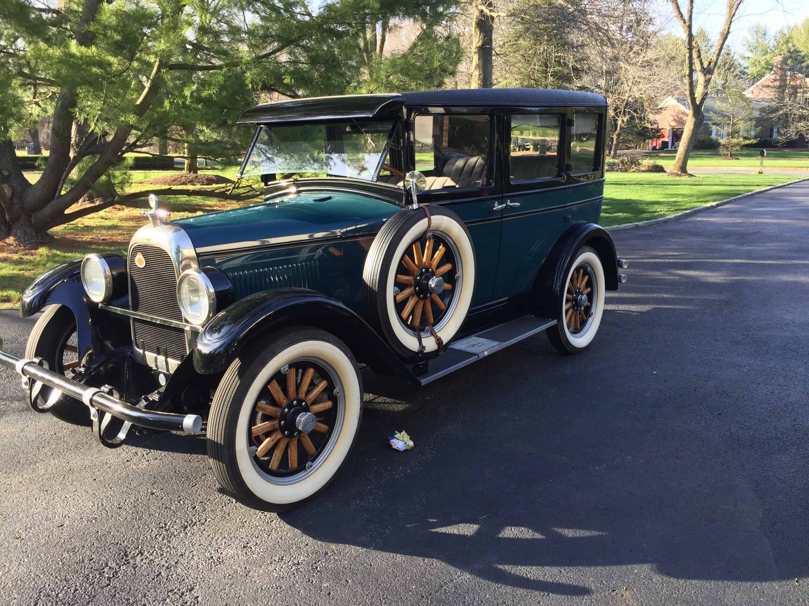

My 1927 Willys Whippet has both a manual choke and manual spark advance, both cables operate through knobs on the dash. The car runs best with both pushed all the way in. However, as I drive along, both the choke and spark advance knobs slowly start to slide out, on their own, causing the car to sputter and lose power. I find myself having to push the knobs back in every couple of minutes as I am driving. There must be a way to fix this.
You can see the choke knob to the right of the wheel
