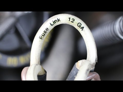

- also if you have a multi-meter, check the voltage as it could be a bad earth or the main fuse for the alternator is blown. on the main wire near the connection there might be a fuse, if the alternator fails it will blow this before it gets to the battery. called fusible link .
Sounds good, but looking at the wiring diagram you can clearly see there are no fusible links. Only one 450A Mega Fuse.
