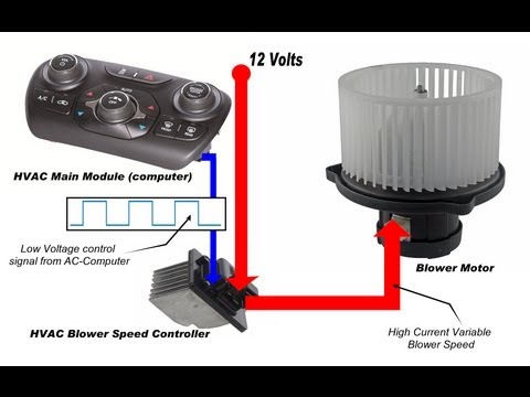

The rear blower motor fuse (Fuse #28 10 amp) is the fuse you are describing. As a test for the blower motor circuit, remove the rear blower motor relay(RR BLO Relay). If the fuse still blows you for certain it has nothing to do with anything downstream from the relay in that circuit. Use the provided wiring diagram for reference.
1999 Cadillac Seville Rear Blower Motor Wiring Diagram
1999-cadillac-seville-sts-rear-blower-motor
