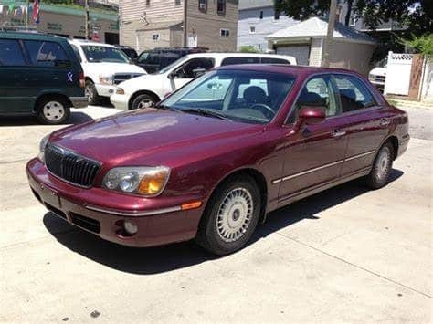

The car alarm goes off sporadically while just sitting on my 2001 Hyundai XG300 . Is there a fuse that can be removed or wire to disconnect that will keep this from happening? We don’t need the alarm to work, we just need it to quit going off whenever it wants.
