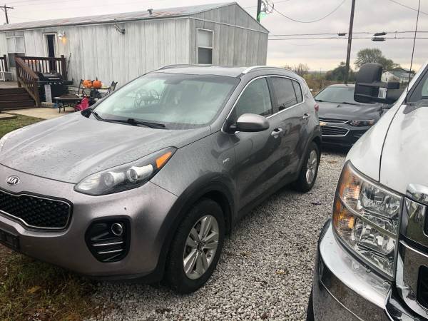

My 2017 Kia Sportage came with 225 55r 17 tires. I have a great deal on winter tires (free) and the size is 235 65r 17…I plan on putting them on new winter rims. Other than spedo issues, are there any concerns moving up to this slightly larger tire?
According to the manual the EX model came with 235/55R18 and the LX came with 225/60R17. And the SX model came with 245/45R19.
TPMS – Tire Pressure Monitoring System if equipped comes to mind. If you do go with a different set of rims you will want to add TPMS Sensors. You will need to perform relearn procedure once you install the new wheels with new sensors.
