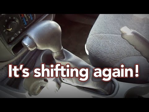

Won’t go into park
Car won't shift into park - Broken Shifter Cable - Replacing a shifter cable - Trailblazer/Envoy
