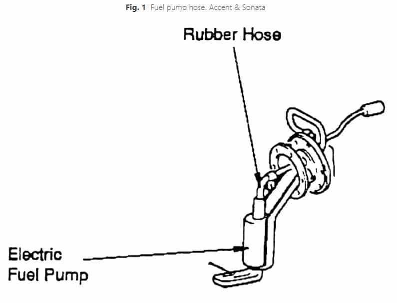

- Disconnect fuel gauge unit connector, then the high pressure hose from fuel tank, Figs. 1 and 2.

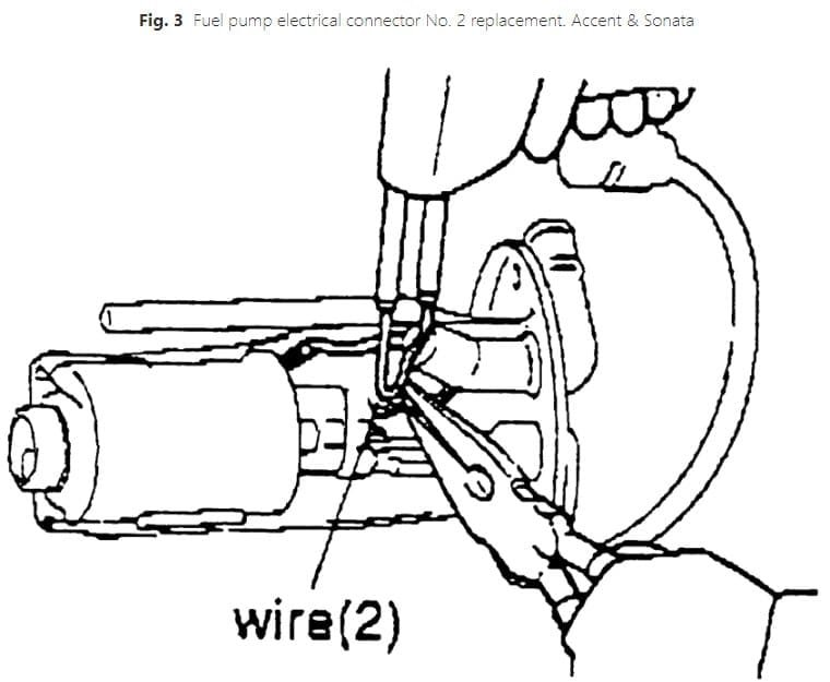

- Disconnect electrical connector No. 1, Fig. 2.
- Disconnect electrical connector No. 2 from fuel pump by heating soldered connection, Fig. 3. Do not use a flame type soldering iron.
- Remove pump from bracket.
- Then Remove clamp and disconnect fuel hose.
- Remove rubber insulator from fuel pump.
- Reverse procedure to install. Electrical connector No. 2 must be soldered to ensure a proper connection.
