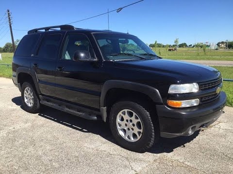

The 4.8 L Vortec engine in the Tahoe is not reviewed well.
