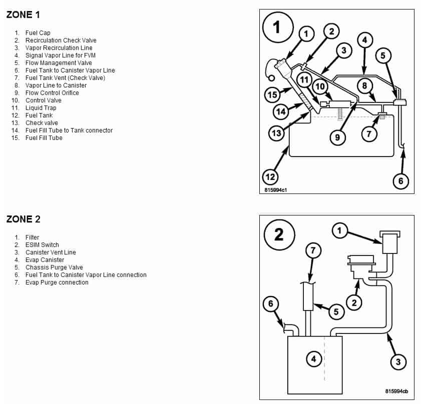

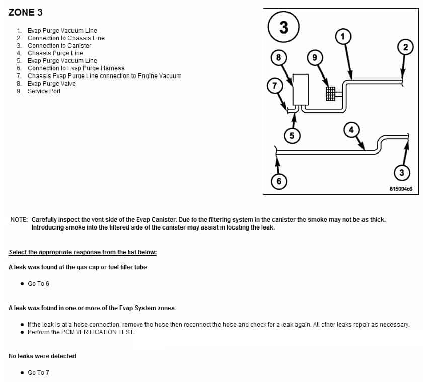

Examine the components for a leak and in a hoses.

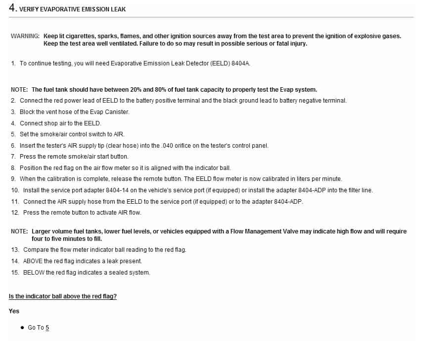

How the shop does it

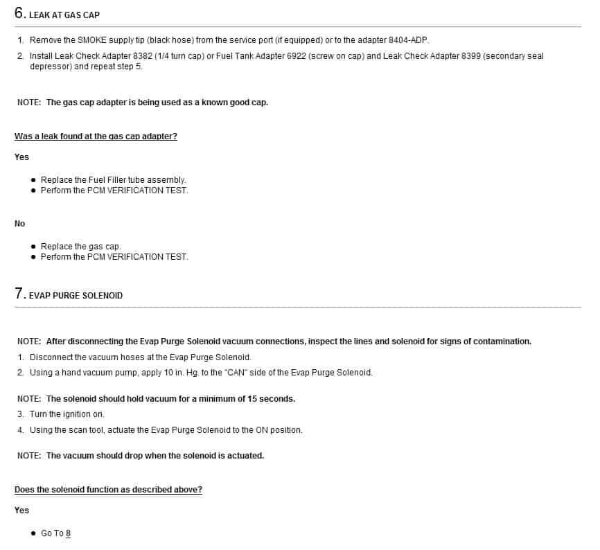

You hook up a smoke machine to the system. Either at the EVAP port under the hood or by venting it into the fuel tank. You watch to see where the smoke is coming from and make the needed repairs. Here is the kind on smoke machine I am talking about.

P0456 Possible Causes
- EVAP Purge Solenoid Vacuum Supply
- EVAP Purge Hose/Tube obstruction
- EVAP System Leak
