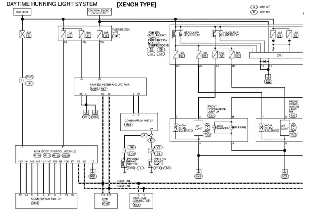

The passenger side headlamp assembly is not working no lights at all. Checked fuses they seem ok. swapped bulbs to driver side and they work
Most likely a wiring or socket issue then. You will need to examine the socket for corrosion and good contacts. Also will need to check the wiring harness. You can use a multi-meter to check continuity of each wire.
This will help you understand how to use a multi-meter to assist you in your diagnosing and testing of the headlight circuit.
