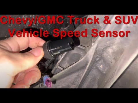

How to replace the Vehicle Speed Sensor (VSS)
Vehicle Speed Sensor Replacement
Removal Procedure
  1. Raise and suitably support the vehicle.
  2. Disconnect the vehicle speed sensor (VSS) electrical connector (2).
  3. Remove the VSS bolt (2).
  4. Remove the VSS (1).
  5. Remove the O-ring seal (3).
Vehicle speed sensor location diagram
2WD VSS Shown Above
Installation Procedure
  1. Install the O-ring seal (3) onto the VSS (1).
  2. Coat the O-ring seal (3) with a thin film of transmission fluid.
  3. Install the VSS (1).
  4. NOTENoticeRefer to Fastener Notice.Install the VSS bolt (2).
    TightenTighten the bolt to 11 N·m (97 lb in).
  5. Connect the VSS electrical connector (2).
  6. Lower the vehicle.
  7. Refill the fluid as required.
