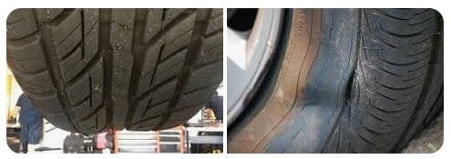

Busted Belt in tire
If your tires are worn it would be in your best interest to replace them. Keep in mind that the problem tire could still be the brand new one, not as likely but still possible. What happens is the internal belt on the tire starts to separate. This causes the tread to become uneven. And the uneven tread will cause a vibration at all speeds. This is referred to as a busted belt in the tire. A little as hitting a metal plate in the road in a construction zone or a pothole can cause this to happen. And can happen to new or used tires.
