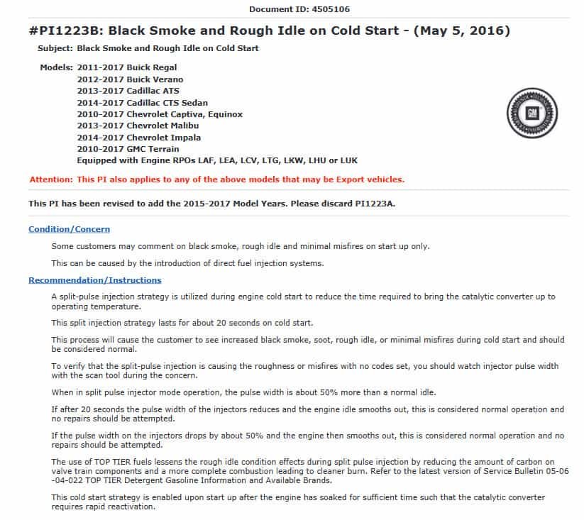

Not sure if this will help understand the issue more but came across a TSB that might help. I’ll post it below. There are other TSBs related to rough idle but are accompanied with check engine light codes. The TSB#16-NA-383 refers to carbon build up on the valves.
Rough Idle TSB#PI1223B
