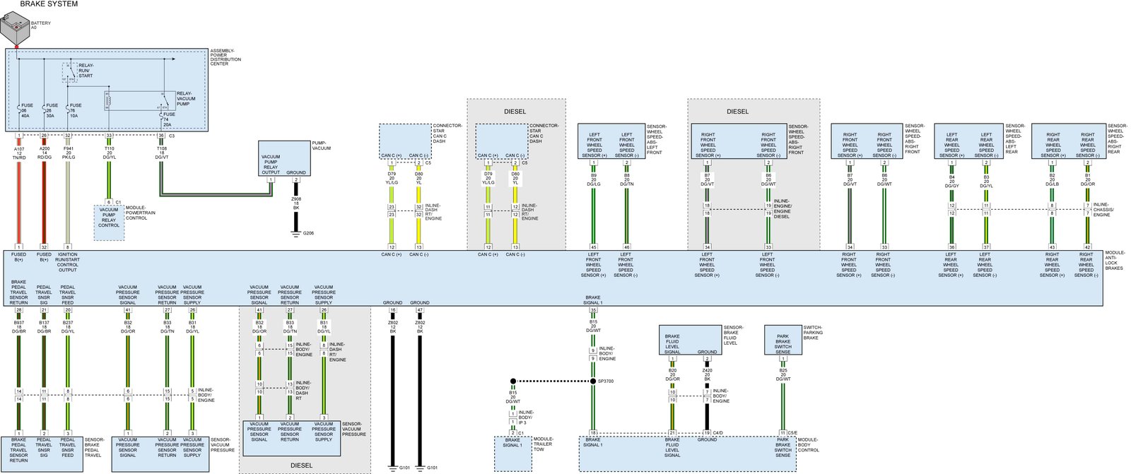

2015 Ram 1500 Brake System Wiring Diagram

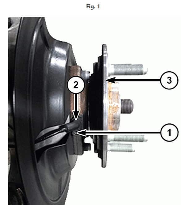

FRONT
Do not reuse wiring harness routing clips, they must be replaced if removed from the mounting holes.
Grease (supplied in sensor kit) should be applied to bearing sensor interface before sensor installation to maintain a watertight seal.
  1. Remove the front rotor.
  2. Remove the wheel speed sensor mounting bolt (1) from the hub (3), Fig. 1.
  3. Remove the wheel speed sensor (2) from the hub (3), Fig. 1.
  4. Remove the wiring from the clips and disconnect the electrical connector.
  5. Reverse procedure to install. Torque sensor bolt to 16 ft. lbs.

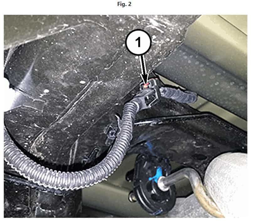

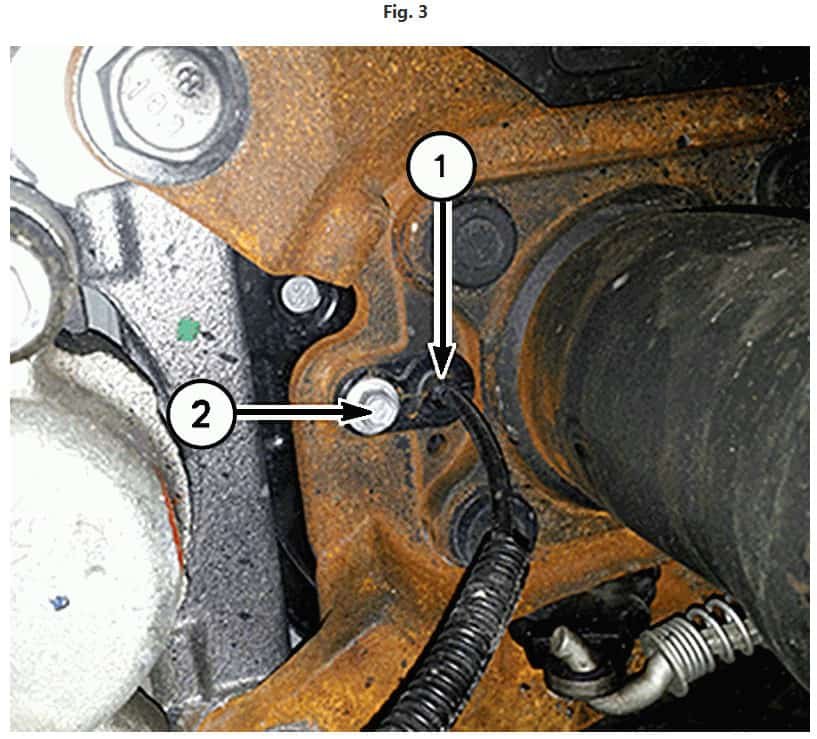

    REAR
  6. Raise and support the vehicle.
  7. Disconnect the wheel speed sensor electrical connector (1), Fig. 2.
  8. Remove the mounting bolt (1) from the sensor (2), Fig. 3.
  9. Remove the sensor (2), Fig. 3.
  10. Reverse procedure to install. Torque wheel sensor bolt to 17 ft. lbs.
