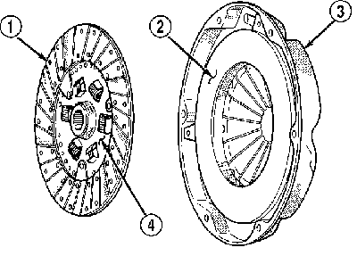

  4. Remove cover bolts and remove cover and disc. Clutch disc and pressure plate inspection
Clutch Disc and Pressure Plate

  8. Inspect condition of pressure plate surface of clutch cover. Replace cover if this surface is worn, heat checked, cracked, or scored.

Clutch Disc Inspect
  1. Clutch disc should slide freely on splined input shaft but it must not show evidence of radial play.
  2. Inspect clutch linings. If linings are oiled, scorched, torn, or worn considerably, install a new clutch disc.
  3. Measure disk thickness and verify there is sufficient material remaining per manufacturers recommendations.
  4. Inspect clutch disc for run out at linings.
  5. Inspect torsion damper for firm seating and inspect spring supporting plates for cracks. Replace clutch disc if detective.
