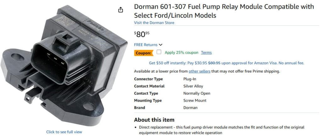

Your job is to determine which one of these the engine is not getting and correct it. In your case I am curious if you tried spraying starter fluid through the air filter to see if it will start and run as long as you continue to spraying starting fluid in. Given the vehicle has a previous history of a failing FPDM that may be a good place to look. Either way it sounds like you may have a flooding issue. To check for that, I would crank the engine a bunch trying to start it(knowing it isn’t going to) and then pull the spark plugs to see if they are wet. Not wet, no fuel. Spray starting fluid in while cranking( and foot partially on gas pedal) and see if it runs on that. Definite fuel related issue. I suspect a failed FPDM again. I looked up a replacement for you as it is under $100. Easy enough to do it yourself.

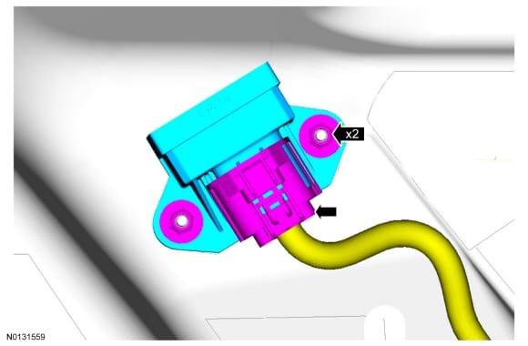

FPDM Removal
NOTE: Removal steps in this procedure may contain installation details.
  1. Remove the RH C-pillar trim panel.
    • 6 Nm (53 lb-in).
Installation
  1. To install, reverse the removal procedure.
