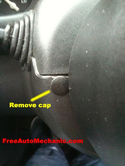

How do I replace the indicator/main headlight beam stalk? I need to dismantel the cover round the steering column. 3 retaining screws are removed from underneath the column but the cover only partially unclips. How does the cover completely split apart so that I can get to replace the indicator/main beam stalk?

  1. Step 1.
    Firstly use a Phillips screwdriver to undo all 3 screws underneath the steering wheel holding the steering rack casing. These out should allow the plastic casing to be loose and able to move around slightly.
    Step 2.
    Turn the steering wheel to the left/right to access two screws that hold the top and bottom section of the rack casing together. The plastic covers just lift off exposing the screw.
    Vauxhall Steering Column cover Removal
