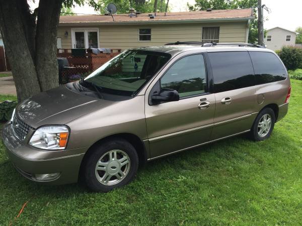

2005 Ford FreestarNovember 5, 2015I cannot get it to start I have a fresh battery with proper voltage, just installed a brand new starter. I’ve checked for voltage on all the fuses and relay points as well as at the starter. The van will not crank at all. Keywords:freestar1 thought on “2005 Ford Freestar” Freeautomechanic November 7, 2015 at 11:30 am Check for good ground at starter. Check for battery voltage at the “S” terminal while someone holds the ignition key in the “START” position.2005 Ford Freestar Starting System Wiring DiagramComments are closed.previousDodge neon se 2003next1998 jeep wrangler 2.5 motor
