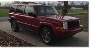

2006 Jeep CommanderDecember 19, 2015 Transmission not shifting into gear some times. Engine will race, but car doesn’t move. Only does this sporadically.Keywords:Commander2 thoughts on “2006 Jeep Commander” FreeAutoMechanic December 19, 2015 at 1:49 pm First check transmission fluid level and color. Top off if low, repair leak if found and test.Fluid is full and clean, electrical issue. Have codes scanned at transmission shop.Fluid burnt looking, transmission rebuild needed. (Most common if Towing is involved.)Transmission Troubleshooting. Randy Chamberlain December 19, 2015 at 4:00 pm Thank you. I appreciate your response. Will have fluid checked first. Then check for code and possible electrical issue. No towing done with vehicle, so hopefully that is not an issue.Comments are closed.previousToyotanext1998 ford escort zx2 hot coupe 2.0 liter ztec
