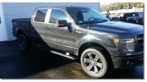

I drive a ford svt raptor 2013, alarm constantly keeps going off and only way to stop it is to leave my doors unlocked. Is there a way to disable the alarm or lock the car with the door not all the way shut?

  1. I suggest replacing the drivers door latch. But if you want to be certain you can have a dealership hook up a scan tool and see which door latch has activated the alarm. I go by the rule of thumb of the most frequently used door.
