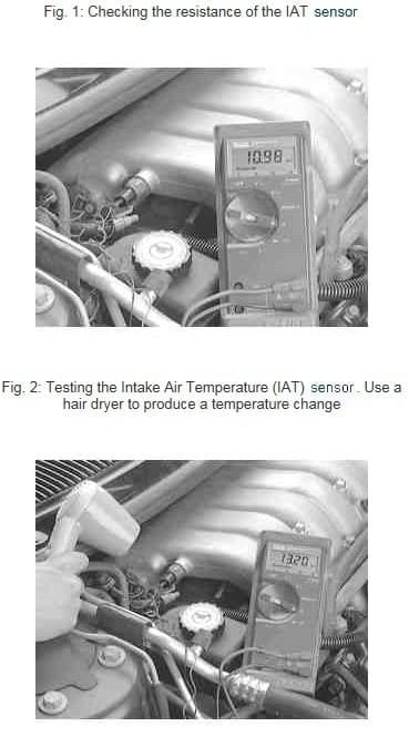

Code 23 Testing Intake Air Temperature (IAT) sensor
  • Visually check the connector, making sure it is attached properly and all of the terminals are straight, tight and free of corrosion.
  • With the ignition key  OFF, detach the wire harness connector from the IAT sensor.
IAT Sensor Testing 1995 Dodge Stratus
  • Connect a digital ohmmeter (DVOM) to the sensor terminals. The ohmmeter should read as follows:
    1. With the engine and sensor at normal operating temperature, about 200°F, the DVOM should read about 700–1,000 ohms.
    2. With the engine and sensor at room temperature, about 70°F, the DVOM should read about 7,000–13,000 ohms.
