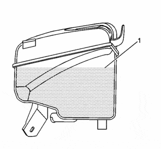

coolant resivior 1998 Cadillac Seville
(1) 1. Low Coolant Level
  • The coolant level should be to the full mark (1).
