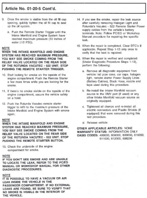

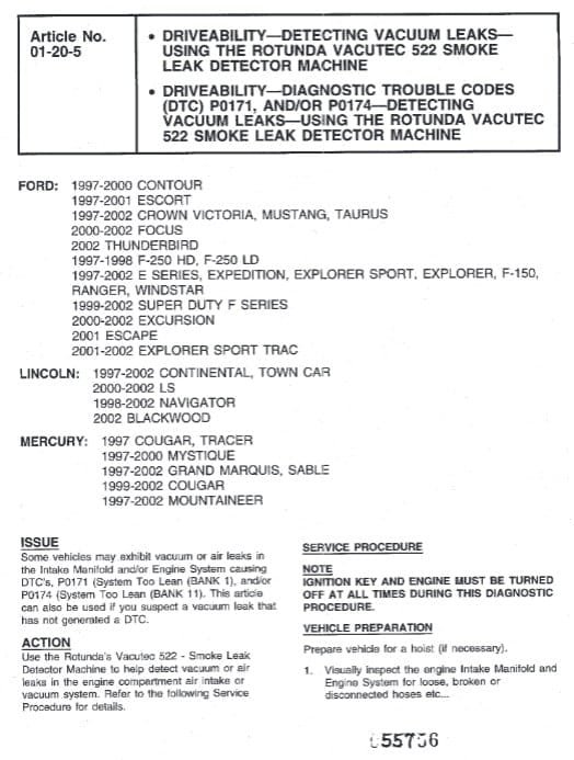

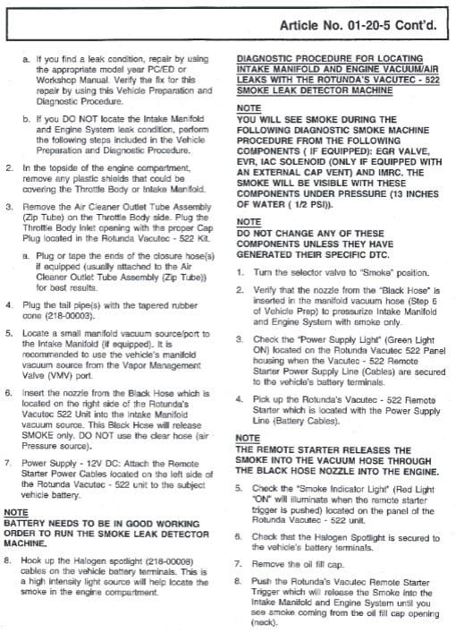

The most common cause for this issue on this specific vehicle would be a vacuum leak. Specifically a cracked intake manifold. There is a TSB on this issue. Confirming the leak would be the first step. you can do this with the use of a smoke machine as recommended in the TSB. Or you may spray starting fluid along the intake with the engine running. As for driving it like this, go ahead. You will just have horrible fuel mileage until you get it fixed.

Ford TSB #01-20-5
